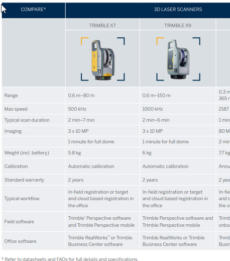

There's a good Trimble scanner comparison document here...https://geospatial.trimble.com/sites/ge ... lish_0.pdfIntroduction to the Trimble X9 3D Laser Scanning SystemDate: May 30

Interesting, so twice the speed of the X7 and nearly twice the range. I had a quick look at one of the sample jobs this morning and the point cloud looked crisp. I'll hopefully have a more in-depth look next week when I get a few moments.Jason Warren wrote: ↑Fri May 26, 2023 2:06 pmThere's a good Trimble scanner comparison document here...https://geospatial.trimble.com/sites/ge ... lish_0.pdf

Besides range i don't see much difference in scan duration.
Min. time is still 2 minutes.
Or am i missing something?

x7 is 500khz or 500 thousand points per second, x9 is 1000khz or 1 million points per second, so twice as fast to capture the same density of point cloud. Put another way, what you get in 2 minutes on the x9 would take 4 minutes on the x7.landmeterbeuckx wrote: ↑Fri May 26, 2023 2:57 pm Besides range i don't see much difference in scan duration.

True but still 2 minutes in this day and age is still a long time. with time needed to move the scanner you need say 2.5 minutes per scan minimim so that's a max of 24 scans an hour <200 a day. That's with all other equipment available not productive anymore, let alone the competition of slam.smacl wrote: ↑Fri May 26, 2023 5:44 pmx7 is 500khz or 500 thousand points per second, x9 is 1000khz or 1 million points per second, so twice as fast to capture the same density of point cloud. Put another way, what you get in 2 minutes on the x9 would take 4 minutes on the x7.landmeterbeuckx wrote: ↑Fri May 26, 2023 2:57 pm Besides range i don't see much difference in scan duration.
